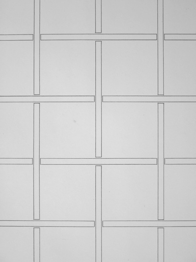

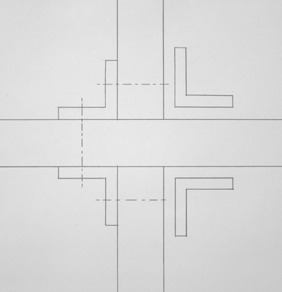

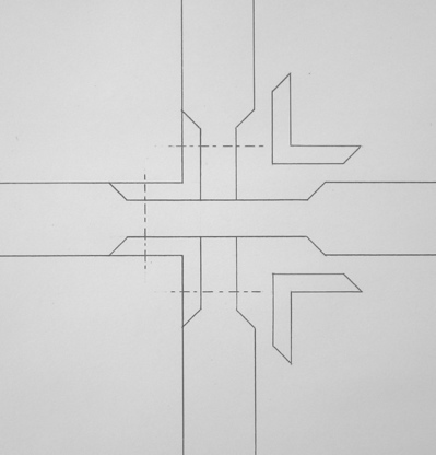

apu, the fastener thing has always bothered me. to get my structural grid members, i'm going to need to cnc route a 20'x40' sheet of osb. i don't think they stock those at home depot. how are you guys planning on making the structural grid? are you somehow going to try to stick to a 4'x8' cut sheet or do you have other ideas? ;)
Apurimac
Total Entries: 49
Total Comments: 4005
09/28/07 14:57
that is a good question ja, but if you can use some sort of fastener to connect the members, you can cut smaller pieces out of 4x8 and then connect them. The issue really is continuous members, which seem to be near the core of "the system theory". You can get really big members cut from steel at steel mills in massive CNC machines, but it will up the cost of the project substantially.
jafidler
Total Entries: 17
Total Comments: 2551
09/28/07 15:21
i thought of cutting members from steel too, but it defeats the point. it seems that the advantage the "honeycomb" provides is redundancy, thus being able to use a relatively weak material like osb and get the most out of it structurally. if you start using steel, there are much more efficient shapes than the honeycomb structure.
this one's going to puzzle me through the weekend.

You could cut sections of 4'x8' OSB so that they overlap-- making your own laminated beams.
The stress skin OR a rigid is essential, right? Otherwise I think the structure can easily collapse.

yeah, with a limited osb sheet size, you would probably need to make some sort of bolted connection between members. the problem then becomes that not all members of the rib fall in the same plane, making it much more difficult to accurately locate the slotted connection. i suppose it could all be modelled, but the structure becomes more a kit-of-parts, similar to a standard moment frame, than the monolithic honeycomb structure i think per envisions. i'm almost tempted to say that it would be easier to field cut the slotted connection than try to manufacture the ribs off-site. i don't think per is going to like that.
maybe i should call it a day and make a fresh start of it tomorrow. this 3dh design work is grueling.

Ignoring for a moment Per's mention of overlaps at joints to connect pieces, may I ask if a layout like the one below is of any structural advantage ?
Then there's the issue of connections. Assuming that the structural frame is to be exposed (and not clad) the appearance of the connections is an issue.

yeah, i missed per's post where he explained you would need to use some sort of steel dovetail joint between members in the ribs.

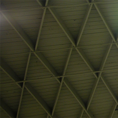

09/30/07 1:57
Per
Is this 3DH in your mind?
It is a curved surface, it's just a small detail of it, and those horizontal Tubes are sprinkler, it is not structural, the only structure is the wood.
You can see the memebers are slightly offset where the ends meet, this allows the two memebers to be fastened to the middle member by a sinlge bolt that passes through all three members.

These are old and I agrea , but please remember not to critic the design --- these are only graphics to explain what is possible , with a different attitude, an attitude that beside make some real suggestions about the actural structure ;
http://www.designcommunity.com/scrapbook/images/2019.jpg

to me 3dh depends on a lot of slotted connections which aren't
all that stable imo... and do they really carry loads effectively?
again this is what i see as a limitation and per sees as an
advantage.

Those are all open questions, no doubt. I can't tell if Per has moved beyond the slotted connections in his conception. He has referred to metal connections, lately. I agree that the simple slotting together of long pieces of material is fraught with hazard, and implies (to me) impossibly large pieces, weakened by those slots -- an unrealistic unlargement of a miniature idea.
Per has shown renderings in which the cells are oriented diagonally or (almost) horizontally, resulting in large peices which are seemingly unsupported and are certainly performing no structural function.
Per seems fascinated by the way in which interior elements like floors and partitions "grow naturally" or "appear magically." To me these are just normal functions of the technique. They are certainly not surprising, as far as I can tell.
Even with today's (and tomorrow's) materials and techniques of fabrication, there are limits to the degree in which things can be enlarged in scale. Isn't it true that an insect enlarged to the size of an elephant would collapse ?

I wonder if anyone realised how to solve the slot connection "problem" that this problem was transformed into a simple universal fitting , cut in same sheet material and numbered ? another suggestion for a entrance type, earthquake safe houses ; and if it is allowed me to ask something ; was earthquake safe houses or addisional earthquake securing structural additions irelevant, or is this no issue to "answer"" ?
